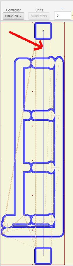

I have just noted that the autoleveller does not handle the Linuxcnc G82 command (Drilling Cycle, Dwell) correctly. This command will retract the tool after the drilling operation to the Z level before the execution of the command.

which will mill the surface rather than move above it. This is also shown in the attached picture, indicated by the red arrow.
Does not handle G82

Re: Does not handle G82
The way I read this is the first part of the command adjusts for the height of the surface (#100) and then it will drill down the 0.2540 depth and then dwell the required time and return to the proper height.
The problem is the G0 move on the last line of the code extract that is done at #100+-0.254:
G00 X33.02000 Y73.74000Z[#100+-0.2540] ;segmented line. Max segment length set to 5
It should be:
G00 X33.02000 Y73.74000Z[#100+1.000] ;segmented line. Max segment length set to 5
Hi yes I think I can see the cause of the problem. Autoleveller does its levelling business on any line that it thinks Z is negative. On the G82 line it drills down to a negative value but actually will pop back up to a positive value at the end, but this line doesnt explicitly state this. Therefore in the next G0 line, Autoleveller still thinks Z is negative and will attempt to level Z, whereas Z is not really negative and should be left alone.
Thanks for pointing this out and I will try to publish a fix for this. In the meantime though, I suppose the easiest workaround is to ensure your drill holes are "deep enough" and not run Autoleveller on this drill file, only on the milling files.
EDIT: So what I mean is that even though the R / retract value is set to 1.000000, Autoleveller ignores the R value and just looks at Z. So when it gets to the next G0 line it thinks Z is still a negative value and Z will need to be levelled and set explicitly, which of course is not the case.
