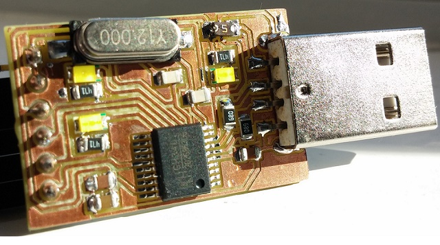

So I figured I would upload a picture of my latest piece of work.
Unfortunately, due to the REALLY tight picture limits on the forums (256kb, 640x480) you can't really see it in any real quality :(
Eitherway, it's a USB to serial converter I made using a CH340T adapter for use with arduino mini pros. It was cut at 0.075mm depth with a 0.1mm pyramid engraving bit and passes for a 0.3mm spacing. Whether it is actually that size or not, I don't know because the cutting tools I have are pretty inaccurately ground.

That looks great! Did you hand solder or reflow the joints! I have been contemplating trying to do some smd, but am a bit concerned as the method to use. Also my eyes "ain't" what they used to be!!

Little bit of solder paste for the 0805 packages and reflow and then I used the old solder/suck technique for the chip as I don't have any syringes yet for my solder paste.
If you've got a hot air station, SMD suddenly becomes extremely easy.
Saying that, even if you haven't got an a hot air station SMD is still easy.
If you wanted to solder the small 0805 resistors for example with an iron, you would put a blob of solder onto one pad first, then position the resistor over the blob and then reflow the solder and simply solder the other side of it.
That chip that's on the board, same idea just solder 2 pins opposite to each other and then what I did was flood the pins with solder on both sides and then one side at a time, reflow the solder and remove with a solder sucker.
Easy!
