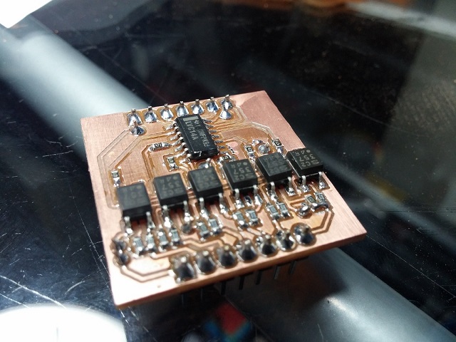

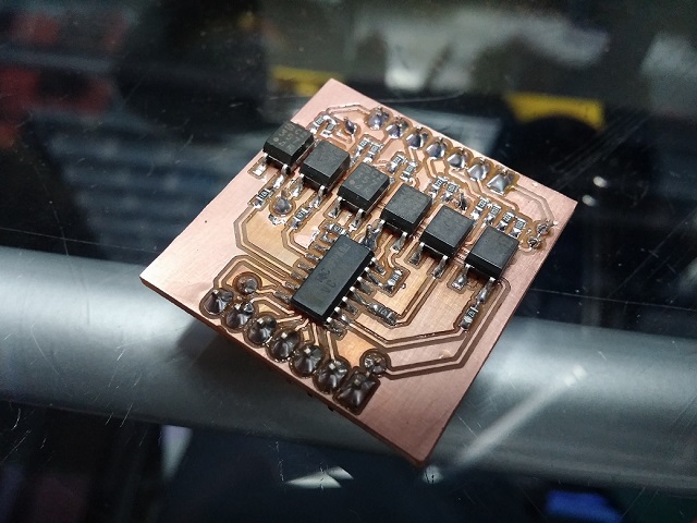

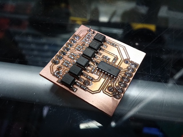

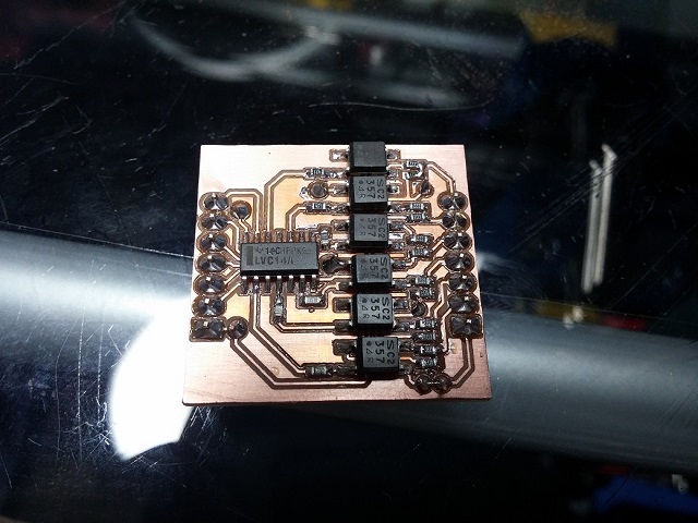

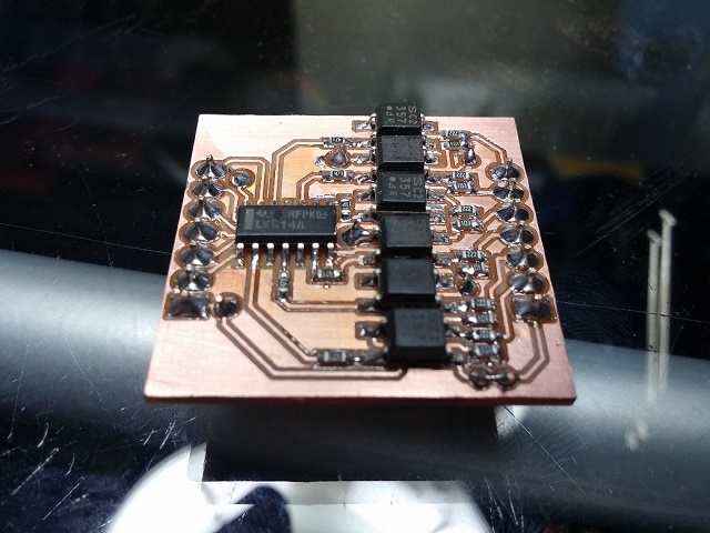

This is the result of the board milled just now with this setup.
Traces are 0.33mm and those are 0603 resistors on the board with opto isolators and a schmitt inverter.
By the way, this is part of a project for a modular CNC machine board. Much like the RAMPS for GRBL and 3D printers, but this is to have a parallel port, hence the opto couplers and inverter and will be designed to use the cheap a4988 modules. I'm hoping for a small board, much smaller than the TB6560 board I have which is entirely modular, including the input buffer, drivers and power supplies.
I've not yet tested this board yet so it might be a complete flop. I'm just enjoying basking in how awesome it's come out :twisted:
