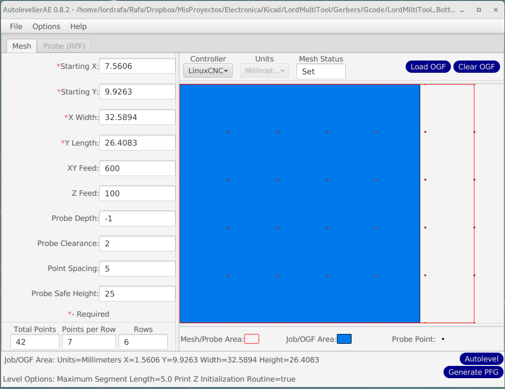

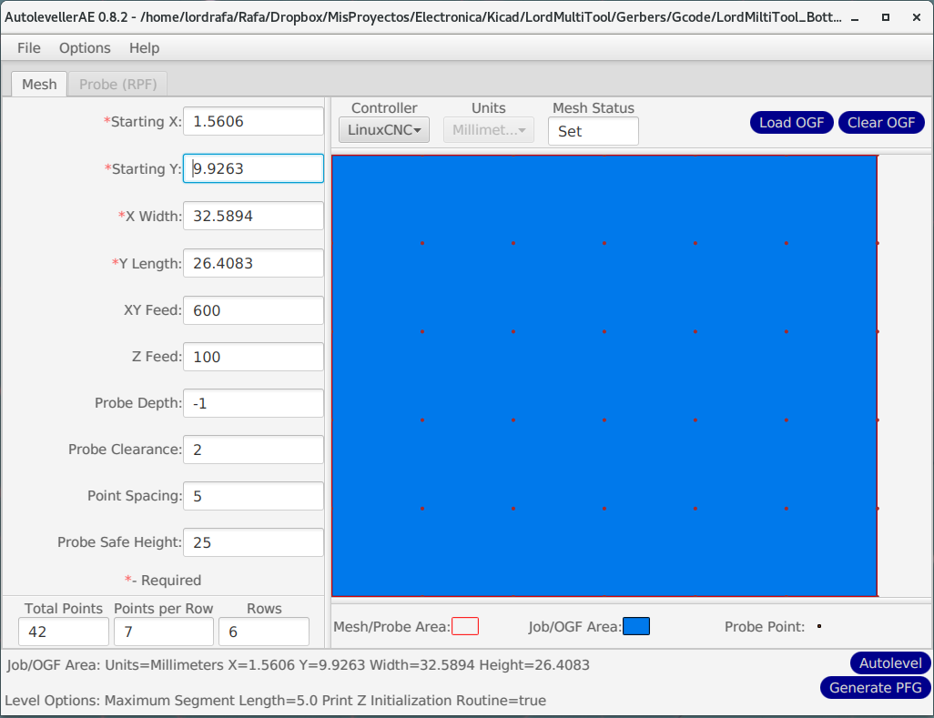

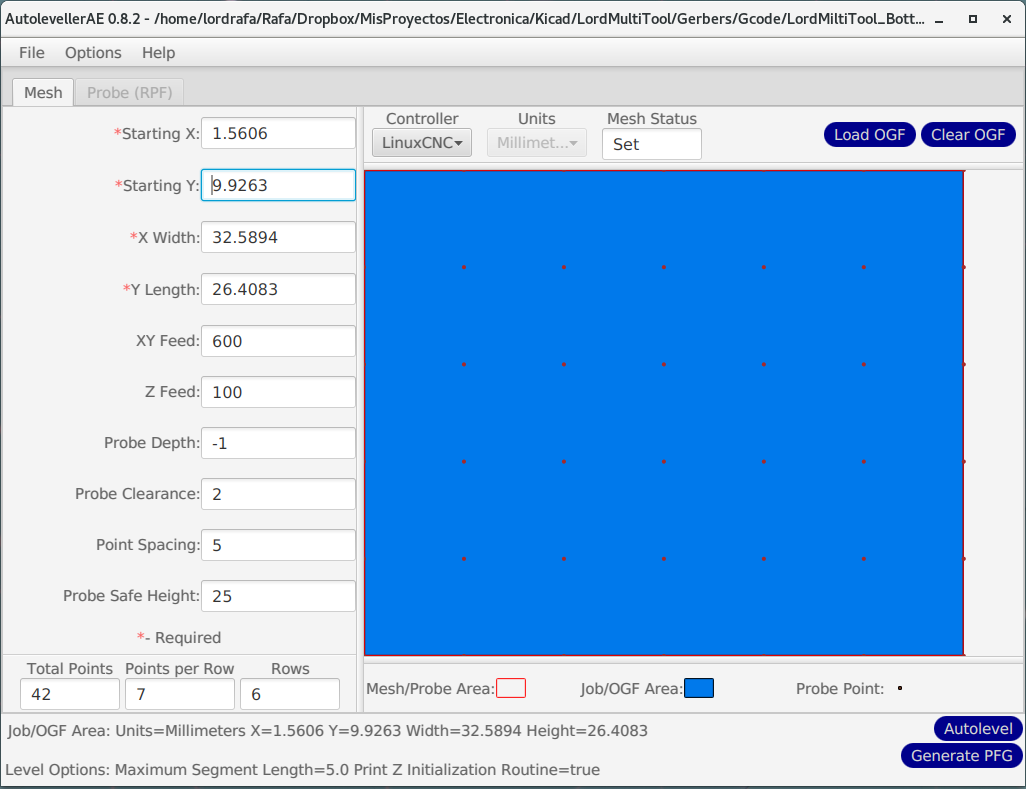

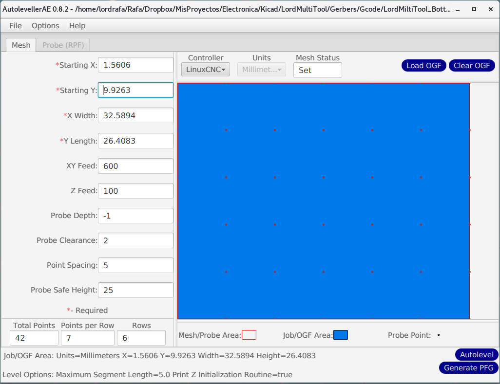

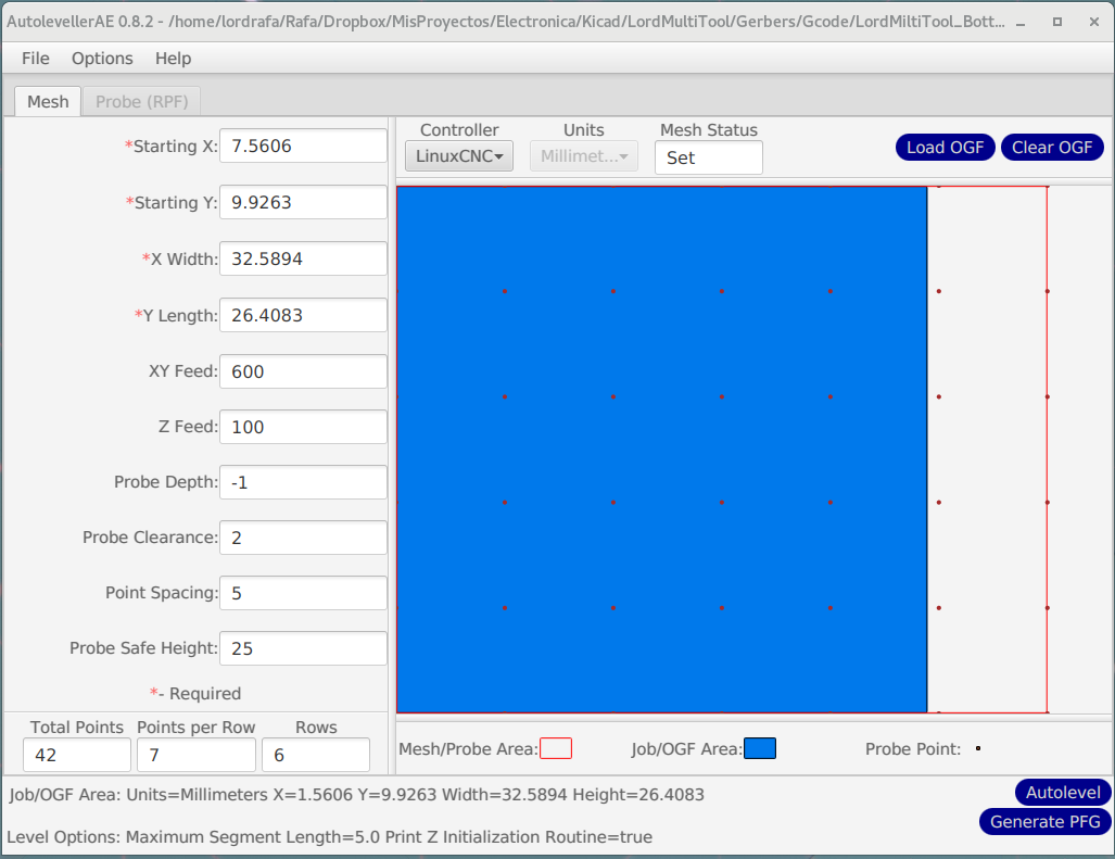

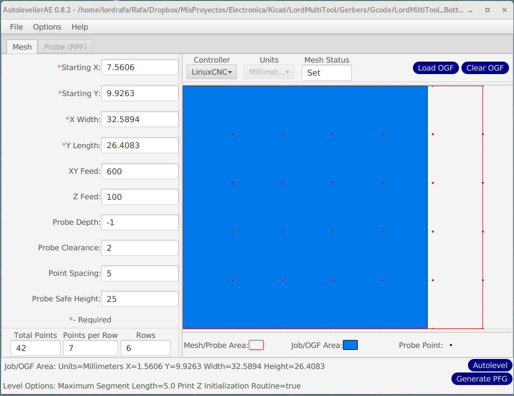

Just one comment more something look a little bit weird when you modify the starting point. If you see in the images that I have attached when I load a gcode file the blue area matches the probe area, as it's expected. However if I modify the starting x I would expected to see the the red polygon move but rather than that it gets expanded.

Checking again I think that what is happening is that the viewer is fixed on the red polygon and since it is moving part of the blue polygon gets hide. I would try to fix the viewer to the blue polygon so when the probe area is modified you can see how is going to be in reference to the PCB.
Keep the PCB fixed on the middle of viewer would make sense since the PCB is not going to change the size but can create some issues if the red polygon increases it's size till the point that doesn't fit in the screen scale out both polygons would be needed so the can fit again.

Thanks Rafa,
You are completely correct about the red polygon (mesh / probe area) In fact, if the blue area (OGF) and red polygon are both visible, the X and Y positions of the red box are always fixed in the bottom left corner of the display, so when you change the X or Y values, it appears the box is fixed and the blue box appears to shift left or right, up or down.
This is confusing I know and hopefully I shall provide something better soon.
