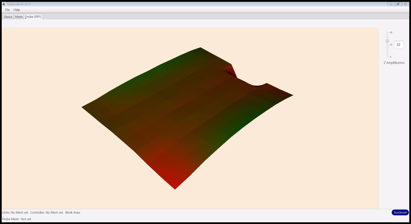

It has long been my thinking that the RPF holds a lot more potentially useful information than just a list of points for AL to use for levelling, if we can just extract and make use of it. First of all, it would be helpful to visualise this data so that we can spot and fix problems before we use the file for etching.

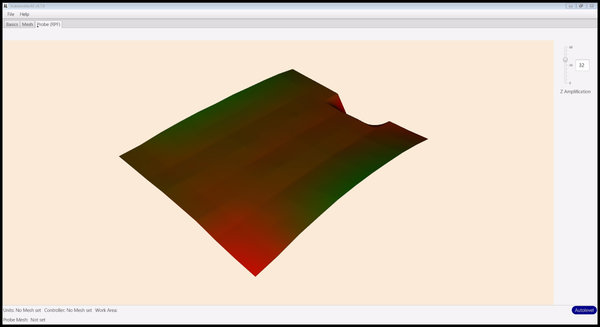

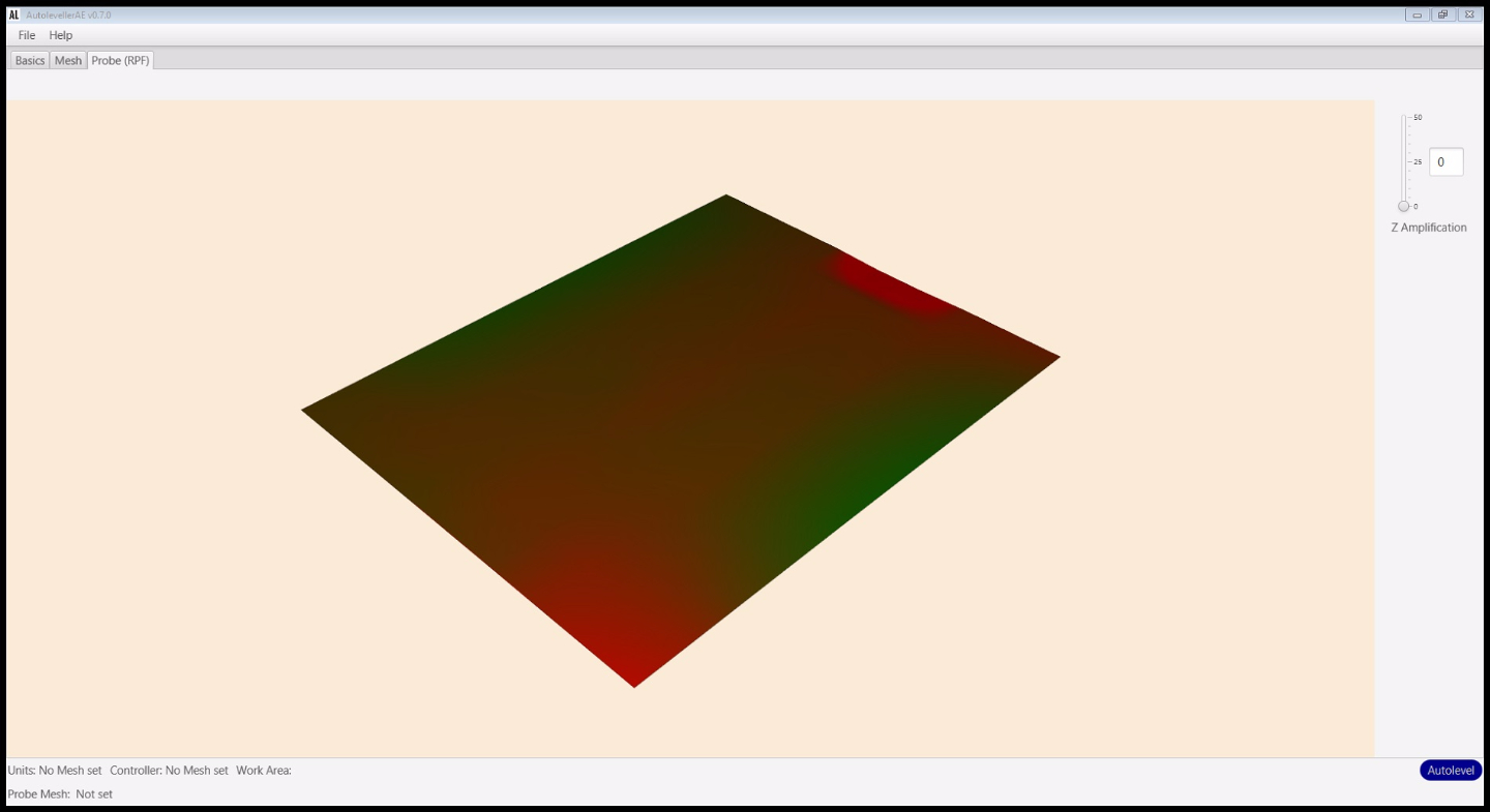

The new RPF 3D modeling feature AE converts the RPF into a 3D model to give you a much better view of the probing results. as the following screenshot shows.
A colored image showing height is generated and mapped onto the 3D model where red areas show low Z numbers and green is high Z values. From the image we can see the top and bottom edges bulge upwards, and the corner closest to the camera and the edge furthest away are the deepest parts.

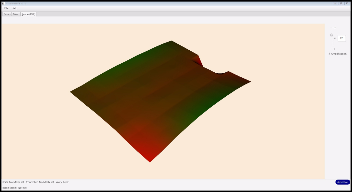

We can amplify the Z parts to exagerate the imperfections and make problems easier to see…
The area on the far edge is particularly deep (maybe the board was dirty in this area?) and could cause problems when etching. The problem is that the autolevelled GCode will possibly etch too deep in this area if the RPF from which it is generated is giving false readings. I would not have seen this possible error if I had no 3D model to view so its important to check for probing errors with this tool before autolevelling and etching.
I have 2 choices for fixing this, either manually edit the RPF to bring the problem areas into line or give the board I was probing a wipe and probe again. I would be willing to bet that this area appears “flatter” after this second probe.
Its still at a prototype stage at the moment and there is a lot more to add but the 3D model will be a very useful addition in my opinion. I wanted to share this with you guys to see what you think. Any thoughts, feedback and questions on this will be gratefully received. :)
