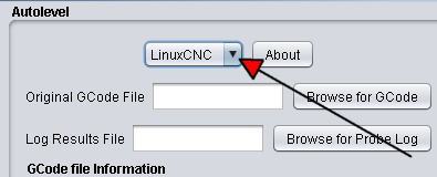

Re: The autoleveller no work in my machine CNC 3040 USB
Looks like you should be doing things properly.
What I was refering to is the drop down menu as shown below:
Then we will have to take it one step at a time to try and figure out what is going wrong.
