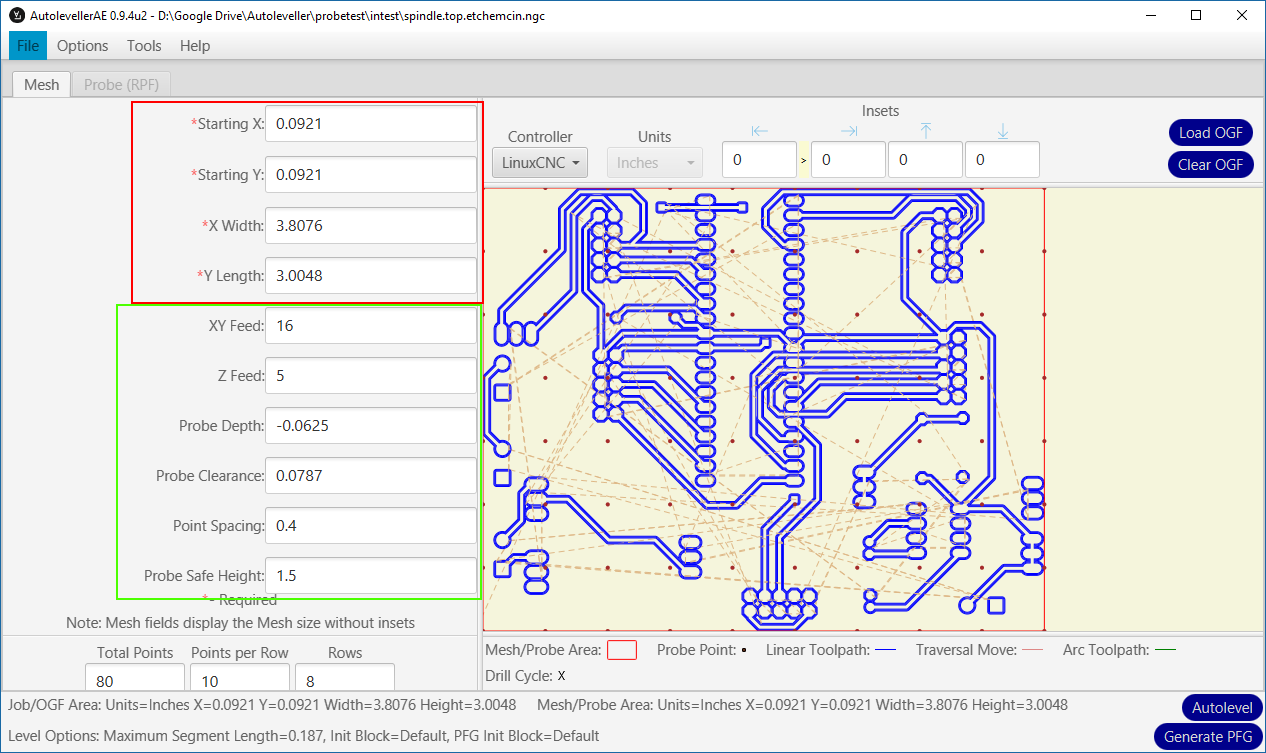

Where does the software get the data for 'Probe Depth and Probe Clearance'? What should the Probe Depth be? The same with Probe Clearance? When I load my OGF and have the mesh use the parameters from the OGF, Probe Depth is -0.0625. Probe Clearance is 0.0787. It doesn't change the values when I load different OGF's.

Sorry for the late reply, been a bit busy these last few days. If you hover the mouse over the fields it should show you a tooltip explaining what these fields mean. Not everything you asked is explained in the tooltips though...

The probe depth means how far beneath Z0 to continue moving down in the Z axis looking for contact to be made before giving up looking for any surface. For example if probe depth is set to -0.0625, each probe will continue moving down until contact is made or it reaches a depth of -0.0625. If you were to change the probe depth to -1", and you forgot to attach the probe wire clip or something it would continue to probe until Z was -1", so this would probably leave a big hole at best as no contact would be made before then. I think -0.0625 is a sensible depth that probably does not need changing, but feel free to do so if you want to.
The red area below shows all required fields for the probe area (mesh) which are the size and position and are automatically calculated based on the loaded OGF. The green area shows all the un-required fields for the probe area and are not linked to the currently loaded OGF at all. They are simply loaded from you settings file no matter what OGF gets loaded. As such, these values will not change whatever OGF is loaded as you say.
