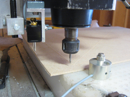

hi all,
i am new here, my name is michael and i am from germany.
i just got a copy of the 0.8 autoleveller software which works fine.
however, my cnc setup is a little different then the pcb setup. i use two probes, which are switches. one i put on the material to get the 0-point, the other is attached to the z-axis a little below the endmill.
when i autolevel, i use the switch attached to the z-axis to create the probe file.
then i create the gcode and use the other switch to get my endmill to the correct position. that works fine but i had to change the o100 sub to the following:
M5 (make sure the spindle is stopped)
M0 (pause for any probe wires to be attached)
G0 X#500 Y#501 (move to X Y position)
G31 Z-10.0 F200.0 (probe)
G92 Z#502 (set Z to position)
G92 Z31.55 (hight of probe switch)
g0 Z38
M0 (pause for removing switch)
G0 Z2
is there a way to put this into the software, maybe importing a .txt file as a o100 sub? otherwise i would have to change it every time and i already killed one switch with the regular o100 :?
as i use a bigger working space (1000 x 500 mm) then a standard pcb the probe spacing in my case is 50mm. the autolevel processed gcode then adjusts the z hight every 50mm but a g1 x50 is processed into g1 x5 g1 x10 and so on.
is there a way to adjust the z hight every 5mm? i guess it would be a simple pythagoras calculation for the points between x=0 and x=50mm. probing every 5 mm takes a lot of time.
thanks,
michael

Re: autoleveller with nonconductive material
Firstly, You can put long code into blocks, and I have edited your post to do this. It just keeps the post shorter and tidier and I will add a sticky in the general section to explain how to do this and other things shortly.
The autoleveller will first break down long segments into 5mm sub-sections or 0.187 for inches so that each section can have its z height calculated. For example, a G1 line which is 13mm will be broken down into 3 parts, 5, 5, and the remaining 3mm. If a move is made where Z is above 0, it is not necessary to break this move down, which may be where you see large jumps.
The Autoleveller was originally designed for small PCBs and 5mm seemed like a good number to use at the time. For much larger files like yours, 5mm is probably too small and will result in much larger AL files. I will include the option to change this number in a future release.
I hope this explains something.
neptunier
Posts: 21
Joined: Tue Sep 02, 2014 12:47 pm
Post by neptunier »
i understand that the software breaks down the g1 moves into 5mm sections. the problem in my gcode is that in the first part of the code it does not change the z values every 5mm, see here:
N240G1X5.223 Z-0.9975F600
N240G1X10.223 Z-0.9975F600
N240G1X15.223 Z-0.9975F600
N240G1X20.223 Z-0.9975F600
N240G1X25.223 Z-0.9975F600
N240G1X30.223 Z-1.0625F600
N240G1X35.223 Z-1.0625F600
N240G1X40.223 Z-1.0625F600
N240G1X45.223 Z-1.0625F600
starting at line? 250 it changes with every line, every 5mm:
N250G1Y4.135 Z-1.747743
N250G1Y9.135 Z-1.751054
N250G1Y14.135 Z-1.754366
N250G1Y19.135 Z-1.757678
N250G1Y24.135 Z-1.760989
N250G1Y29.135 Z-1.764301
N250G1Y34.135 Z-1.767612
that is the problem i wanted to point out. why is it inconsistent?
thanks, michael
OK, I understand, thanks.
This is because the Y value is set to -0.865 above. See:
N180(Toolpath:- Kontur 1)
N190()
N200G94
N210X0Y0F600
N220G0X0.223Y-0.865Z2
N230G1Z-0.9975F300
Your probe area starts at X0Y0 so Y-0.865 is outside this probe area and so it doesn't calculate Z as well for those points.
If you want to fix it, you can always make your probe generation file cover a slightly bigger area. Start at X-1Y-1 for example. It should not make a lot of difference though.
