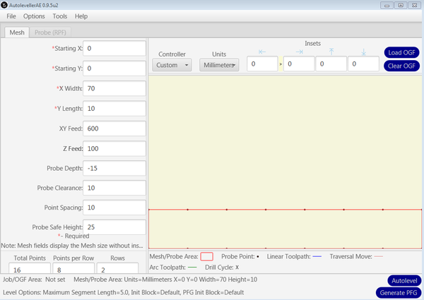

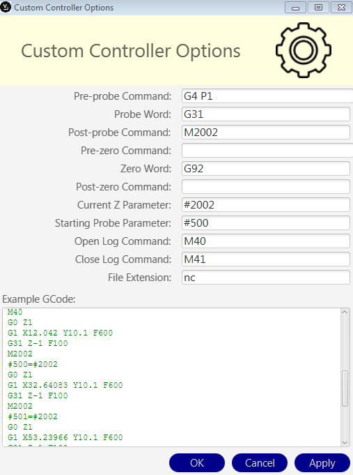

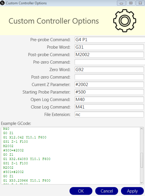

This is my current configuration
For M2002, I have a macro in the active profile directory with
SetVar(2002,getoemdro(802))
The PFG file is also attached
A snippet of which is pasted below

My question is why the G92 codes are not showing up after the M2002 command.
I would expect that after a probe detect the Z should be zeroed? correct?

Yes sorry you are correct. Was in a rush before and got a bit confused with what GCode does what. Yes, the G92's are for zeroing only and should only appear at the start. This is so the rest of the probe commands (G31's) have 1 zeroed point to relate to. Here is an example of a PFG which I quickly generated:
