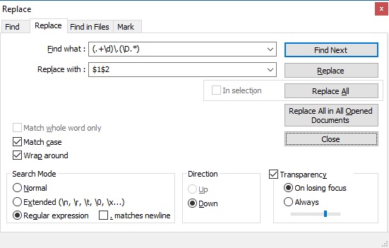

I think the main problem here is Fusion 360 because it is designed for 3D modelling I think, and inserts lot of GCode swapping planes and changing Z's. The viking head turned out well so Fusion 360 obviously works sometimes when the trailing periods are removed from the gcode. I dont know fusion 360 but is it possible to design in a way which does not cause the problems, now that we sort of know the issue?
To remove the trailing periods, you can load the file in notepad++ and press ctrl+h for find and replace. Then select regular expression and enter "(.+\d)\.(\D.*)" in the find box. "$1$2" in the replace box. Click "replace all" and it should remove the offending periods. Do this twice or more to remove the remnants where lines contain more than 1 trailing period.
If anyone is curious about the regex, "(.+\d)\.(\D.*)", in English it says "match any line with any 1 or many characters followed by a digit, followed by a period, followed by anything which isnt a digit, followed by any number of any characters". The parentheses group the parts of the line so that we can refer to the groups in the replacement. So "$1$2" just says replace each match with the contents of group 1 followed by the contents of group 2, i.e. the same line without the offending period.
