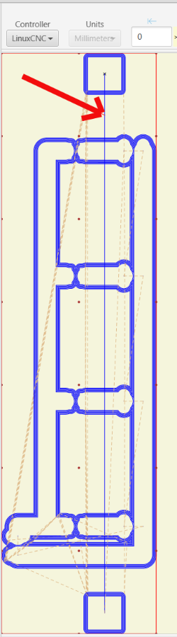

I have just noted that the autoleveller does not handle the Linuxcnc G82 command (Drilling Cycle, Dwell) correctly. This command will retract the tool after the drilling operation to the Z level before the execution of the command.
The following is an extract from the original G-code file:
G00 Z1.0000
G82 X33.0200 Y78.7400 Z-0.2540 F144.00 R1.0000 P1.000000
G00 X33.0200 Y7.6200
G01 Z-0.2540 F144.00
and results in:
G00 Z1.0000
#102=[#522+0.24983*#519-0.24983*#522]
#101=[#523+0.24983*#520-0.24983*#523]
#100=[#102+0.33282*#101-0.33282*#102]
G82 X33.0200 Y78.7400 Z[#100+-0.2540] F144.00 R1.0000 P1.000000
#102=[#522+0.70683*#519-0.70683*#522]
#101=[#523+0.70683*#520-0.70683*#523]
G00 X33.02000 Y73.74000Z[#100+-0.2540] ;segmented line. Max segment length set to 5
which will mill the surface rather than move above it. This is also shown in the attached picture, indicated by the red arrow.
Does not handle G82
