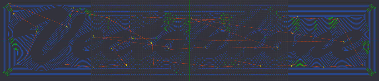

This is a test gcode file (millimeter units) opened in CamBam:
Original image of the vectorphone toolpaths opened in CamBam

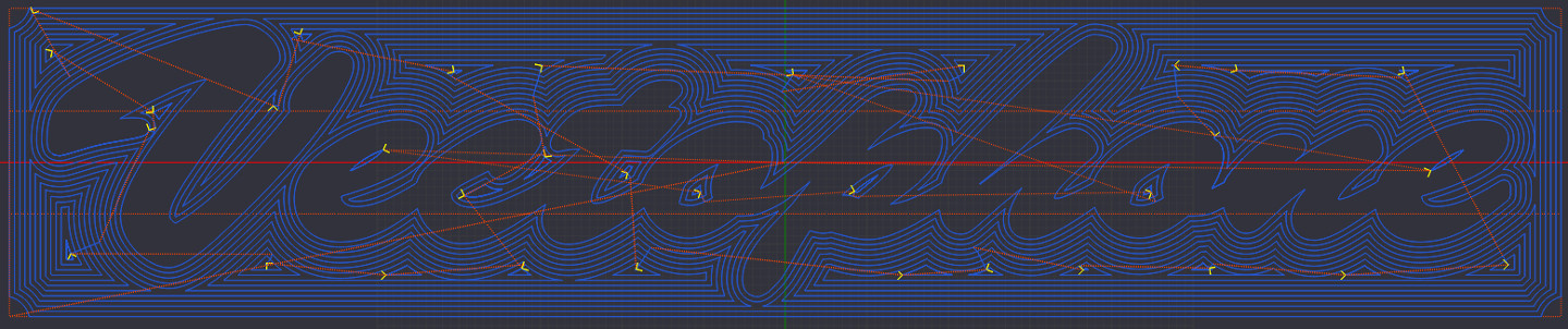

CamBam is great for showing me what I want because toolpath types are colourised. Blue lines are straight (G0 and G1) moves, whereas green lines are arcs (G2 and G3) moves. The new code converts arcs into straight line segments, so if I take this gcode and pass it through AutoLeveller then load the AL file back into CamBam:
Converted image of the vectorphone toolpaths opened in CamBam
All the green lines are now replaced with blue ones and the image looks pretty much exactly as it did before.

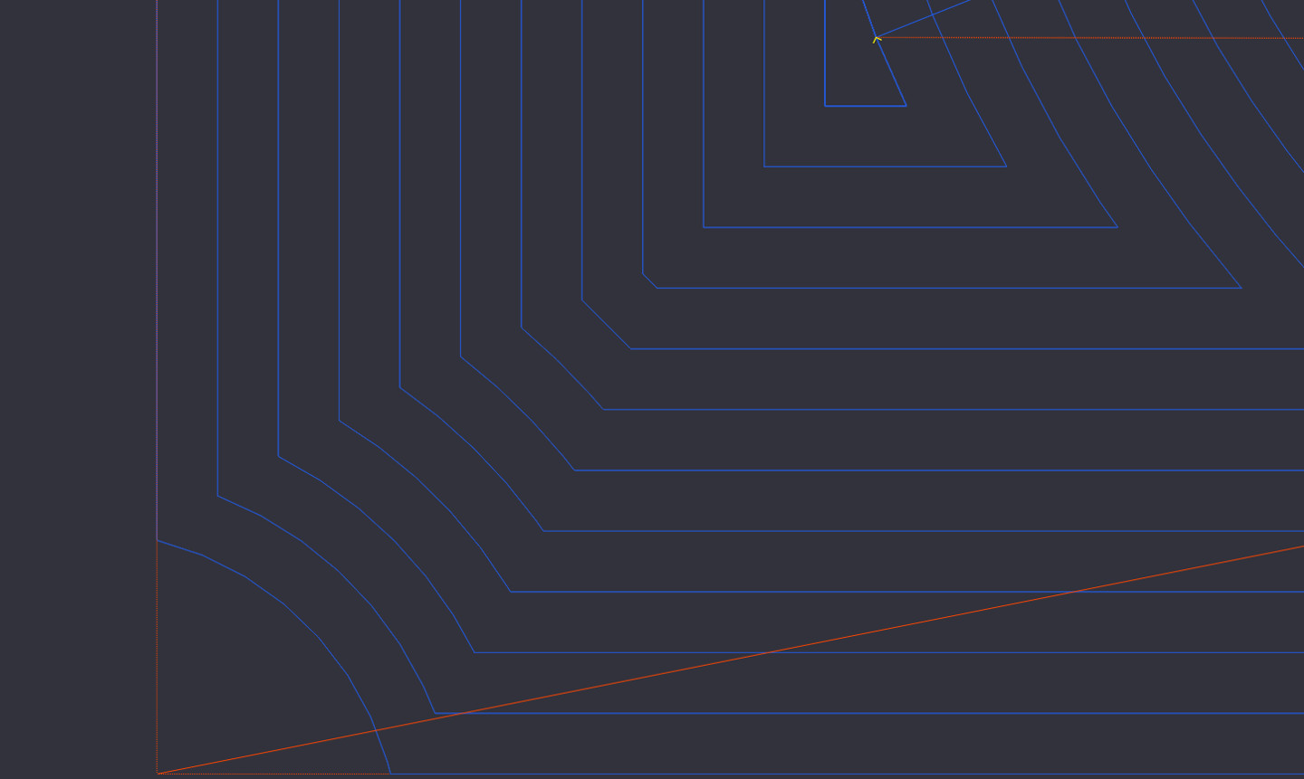

This image is a zoomed in capture of the bottom left of the above image. Arc segments are set to use a 1/2 millimeter size for conversion:
Zoomed vectorphone image with arc segmentation set to 1/2mm
1/2 a millimeter looks very smooth for conversion based on this image alone.

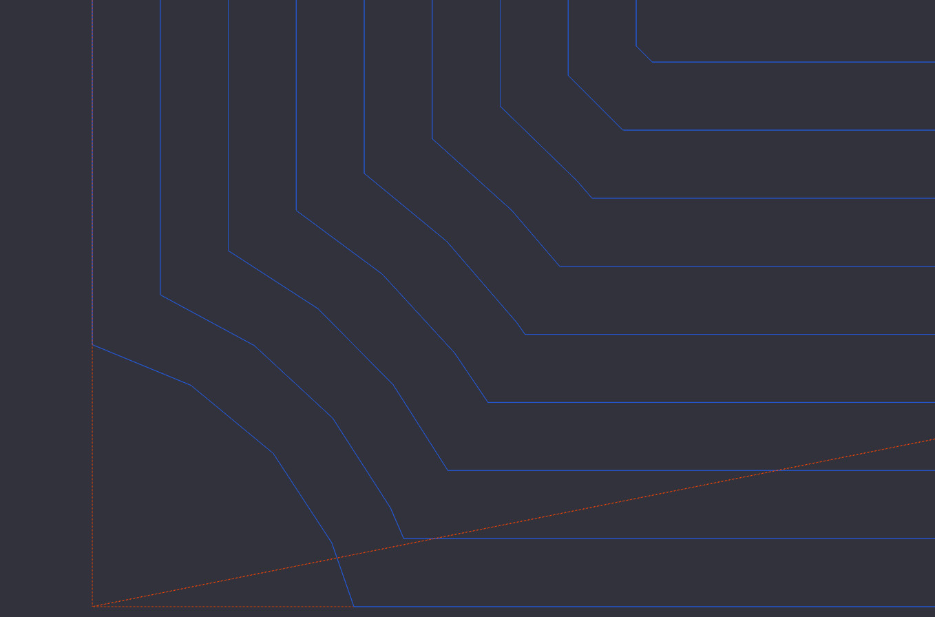

The same area is shown here but with the segments set to 1mm:
Zoomed vectorphone image with arc segmentation set to 1mm
The converted arcs are less smooth here but probably not noticeable when milled. It might be more pronounced if the arcs to convert were much tighter and I can see other issues arising here too.
